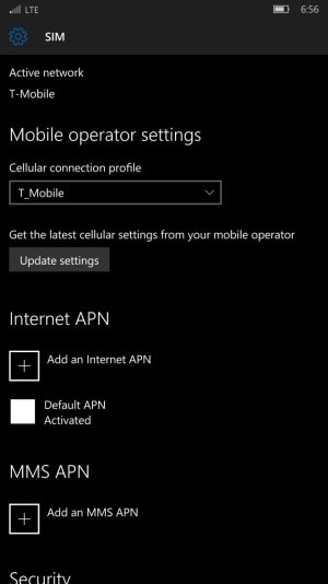

I had a wonky MMS event last night, I couldn't send MMS on my L1520. After editing the MMS APN settings over and over I ended up deleting them altogether and just kept the default data APN. After a reboot, all was well. wp_ss_20160220_0001.jpg

Yep, I followed you fatclue_98, I had it working by adding in 600 for max size on my phone, but also just went back to default like you pictured...both worked for me.
