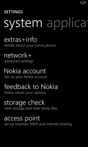

Turning cell data off even while on wifi is no good. Don't get notified of voicemail. I installed this access point program here access point | Windows Phone Apps+Games Store (United States)
Once installed the app is in settings. The 3G option does not work for me. Phone says LTE and gets no data. The other options are LTE 1 and LTE 2. They seem to get the phone working back to normal and seem to be about the same. I'll report back if I notice any difference. I got the app and also tried the manual internet apn settings from the following link but the manual entries I made did not work either http://forums.windowscentral.com/nokia-lumia-920/209413-t-lumia-920-mms-apn-print.html

I been able to change it to 3g (AKA 4g) by going to Settings -> Access Point, there are 3 options ATT 3G, ATT LTE 1, ATT LTE 2, I just selected the 3g AP and its been connecting to only 3g/4g, I see that signal still drops (issue with the 1308 firmware) but at least you'll have better life on battery.
How did you enable "Access Point"? I don't have that option under "Settings". :/
Yeah, I updated last week but I don't have that option. I have "Storage Check", but not "Access Point".
"access point" is not an actual setting... it's an app designed by Nokia that will let you change your apn on the fly instead of having to manually enter it. You can download it from the store.

You can find the access point app in the link I posted on this page several posts back. I wouldn't recommend it though if you are on AT&T. When I clicked on 3G it did nothing. My phone stayed on LTE. When I clicked on LTE 1 or 2 Internet sharing would not work. I couldn't remove the app, since it's not an app so much as a setting. At that point I had enough of the 1308 update and flashed the 1249 back. Phone working fine now on 1249, got the field test menu back, been on 3G with no issues. If someone has success with access point app on AT&T and the 1308 update, please link the app here. Maybe it is different from the one I found. It doesn't appear to come up in a search in Store. Success meaning it actually switches your network to 3G (disables LTE) and internet sharing works - assuming you are on a plan like mine that allows interent sharing (mobile share). Still looking for an LTE off fix (w/o breaking anything else) before updating again. Thanks.
