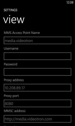

First off all, all 3 issues mentioned above works great on my 920. To fix issues i would suggest you to download Nokia Access Point from this link:
http://www.windowsphone.com/s?appid=ce3895c7-01d0-4daf-a4c3-25c10463942d
Check if it actually shows your carrier in the list, if it does not then create one manually.
Set the internet APN as: media.videotron
Set the MMS APN as: media.videotron
MMSC: http://media.videotron.com
MMS Proxy : 10.208.89.17
MMS Port : 8080
Save the APN, select it, send MMS to yourself to test MMS

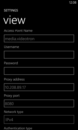

I have access point and it does show Videotron and everything looks perfect on paper but they don't work.
Could you post screenshots so I can compare? I really would love to get these working.

Your settings look correct, not sure why its not working though. Are you able to browse data?

Hi Michael - I have an unlocked Lumia 920 and to get the mms working, I had to delete the manual settings I put into the internet sharing app before I installed the access point app. Deleted the settings, rebooted and ran access point and all was fine after that. Give that a try and see if it works. It was suggested in another thread that without the full reboot, the access point app may not configure things correctly.
Hope it helps.
Yes - the access point app should give you the correct settings, as long as you select the right carrier. If you still find the MMS isn't working, you can input its settings manually in the cellular settings app.
