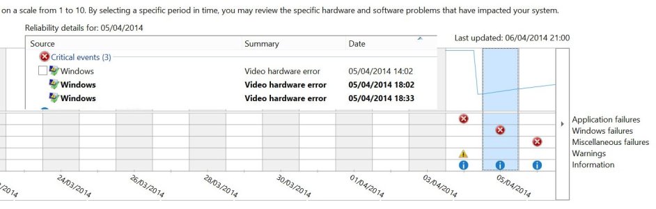

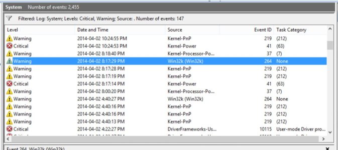

I think in the context of this discussion (Surface 2/RT issues) I would use the term 'Wake Events' to describe when the Surface doesn't initially wake from connected standby. Open cover - nothing. Press power-button - nothing. Press it again a few times and eventually the Surface responds. This is distinct from full-blown Sleep-of-Death when the Surface never wakes up completely - need to hold down the power-button for 10 (long) seconds to restart). In both cases the device is awake beneath a black screen. I think they are the same issue and appear to be related to bad display drivers and/or bad display hardware.
I am suspicious that the issue where the top-left area of the touch-screen 'sticks' is also related to the display driver.
Check the Event Viewer when these occur - bound to see display errors. Also, check the Reliability History - somewhere you'll see a Video Hardware Error (it'll be a red X in Windows failure line), which is the herald of all future display/Wake/SoD events.
See grab below - this was replacement S2 - less than 24 hours after turning it on the H/W error occurred.
