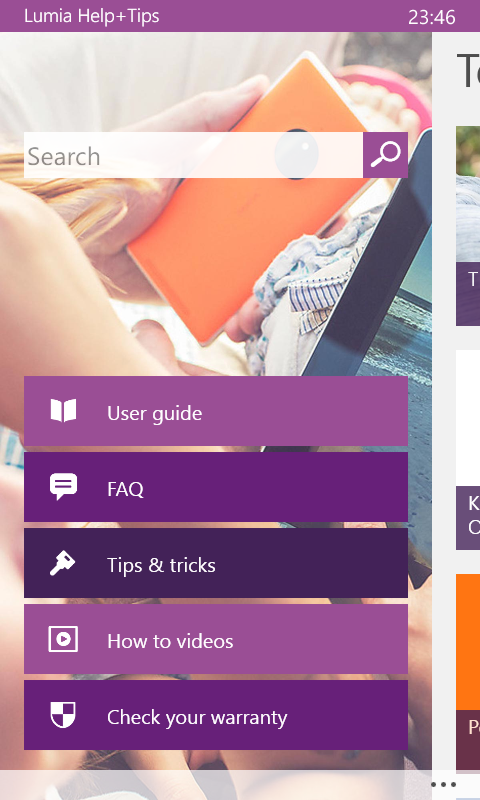

Also you can download Lumia help and Tips and find out your warranty status.
Here
http://www.windowsphone.com/s?appid=ccfdca81-e2fe-44bd-8957-d0c55c636933
