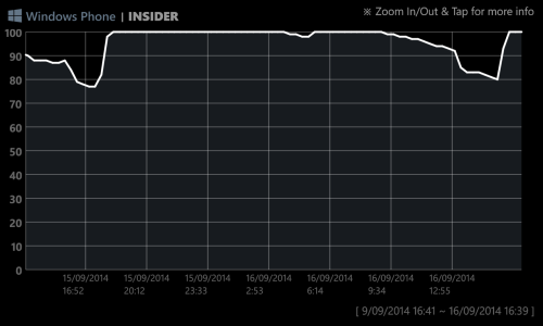

Talking about weird issues with the battery here is a screen shot with light use Location wifi and 3g on but no wifi for a long time. few calls messages and emails synced 2 hours. chk this out
P.S The little dip was charged back to 100 in the morning and then the large dip was heavy use.
