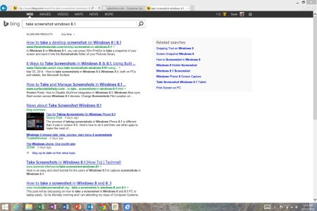

About 2 hours ago, I noticed this yellowing effect on my SP3 screen. Can only see it when screen is why but it's getting more noticeable. It's only down the left side of the screen. Attached is a screenshot I took which you can clearly see. Any ideas as to what has happened here? Unreal. Just using it as normal and this happens.

Perhaps I'm stupid but I cant see anything???
I just realized that I can only see it from my screen capture. I did a little more research and found I am not the only one. Sending it back for replacement as apparently others have had the same issue. Frustrating given that it just actually appeared out of nowhere. I was reading a PDF file and there it was. Thought it was my glasses. Asked 2 others if they can see it and they both said "oh yeah". It's not highlighter yellow but enough where it is noticeable. Rather than take a wait and see approach, given the cost, I don't want to see if it gets worse over time.
Seems like the only practical solution in this case. I obviously can't see it in the image but what you are describing would certainly have a hardware origin and the fix is to replace the hardware. Even if sent in to Microsoft all they would do is send you a refurbished replacement anyway since they don't really service the devices. It has always amazed me when people come on here or another forum with an obvious hardware defect and then ask what they should do. Nice to see someone actually do the practical thing up front instead of encouraging a debate....
