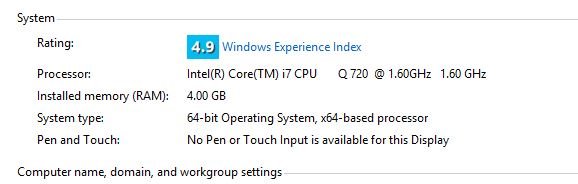

These are my VAIO specs. Too slow?

Your current processor speed is a little on the low side, but I doubt it'll produce results as bad as you're describing. There are probably some other underlying factors. What services do you have running in the background?

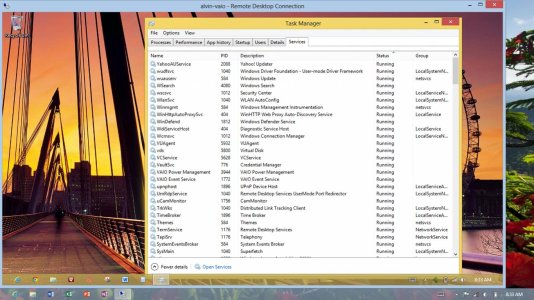

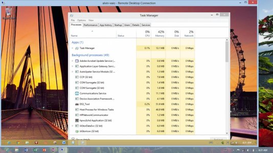

Here are screenshots from the Surface running remote desktop in a window. There are services running, but not really using any resources.

So I've upgraded from a G router, got a brand new N router and refreshed my Surface. My VAIO WiFi speed rate have gone from 54mbps to 144mbps and my Surface has gone from 54mbps to 130mbps. Remote desktop is still sluggish in Modern UI but is now pretty smooth in desktop mode. Anyone else experiencing this?
