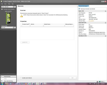

I installed the most recent software and followed the steps instructed in the tutorial.
But I'm stuck on finding my device's code -see first attachment.
What's strange is that if i choose the refurbish option then the product code is shown -the second attachment. Any help on this?

I followed the steps as they were described although the tutorial isn't that foolproof as it should! Thanks again!
