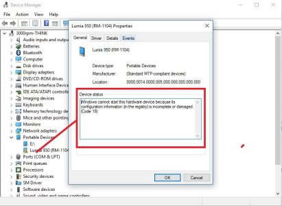

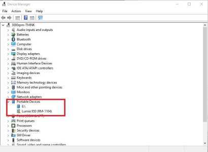

As above, try to update driver and it says encountered a problem, Weird thing is on my old T61 running 10 it works fine, windows phone seen in file explorer and device manager but on my T430 it does not allow the device to be used, it can see the device in device manager but yellow triangle with exclamation mark on it. Any ides please. Photos to follow...

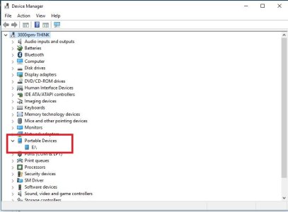

Device manager before i insert the 950 with USB cable, Tried USB 3.0 and USB 2.0 ports, both do the same thing.
Finally in device manager after all of the above the Lumia icon appears differently.

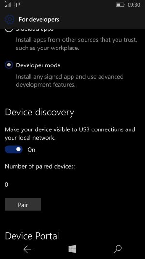

I found this setting in the phone to and it makes no difference either even after restarts etc.

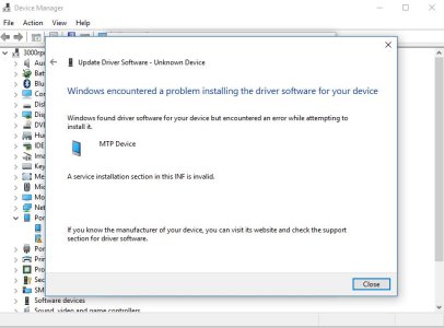

Could someone send me a driver that works, I can then add it via device manager. The online search finds a driver but fails to install it as above. ^^

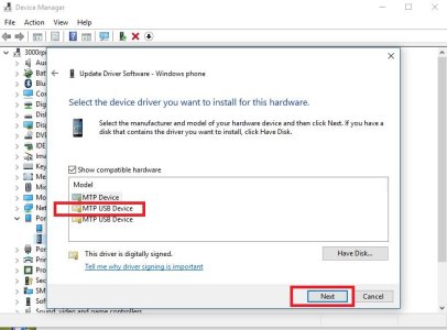

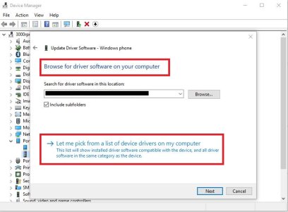

Solved**, I had to manually install the MTP driver files, all ports both 2.0 and 3.0 now work, and on the T61 and T430, also an interesting find was that the computer cant access the phone when screen/phone locked, a nice security feature, no traffic from laptop to phone possible, All good now, thank god. Today I have read horror stories about people resetting their entire laptop to fix this issue, no way was I doing that! Took a while but I got there in the end.
Right click phone in device manager (yellow exclamation warning)
update driver, select from PC
Then select from Drivers on PC, select MTP driver, boom all good, Files can only be transferred when mobile is UNLOCKED!
