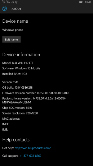

Been able to get .218 on the 15010 (Worldwide) firmware, quick tutorial:
1. Install 15010 firmware if you have x150e and haven't installed it already.
2. Install Insider app and choose fast ring, once enrolled check for updates and update the phone (this should get you to the 10586.107).
3. Once updated quickly before it checks for updates navigate to the insider app again and switch to the production ring.
4. Check for updates, this should get you to the .218 on production ring using 15010 firmware. (Or supposedly to the .242 after 10th May)
NOTE: if it did check for updates once .107 got installed and started downloading RS builds then perform a hard reset (settings->system->about) and simply proceed with step 4.
Credit goes to abhijit pore for telling that in the fast ring using 15010 firmware it gets to the 10586.107 before going to RS.

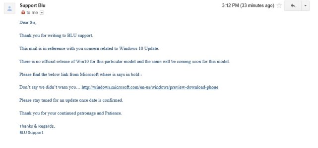

blu.jpgI enquired blu support regarding the upgrade....I got this news from them...
I would suggest noobs to stay away from insider builds...
there is still no official upgrade to win10 for x150e....maybe till may end or early june.....ms has included the hd lte device in insider program so that the device can be tested and reqd changes for drivers can be made by the oem before official upgrade....so right nw the upgrade is only for testers....

View attachment 126115I enquired blu support regarding the upgrade....I got this news from them...
