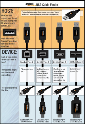

Based upon what you just said, the DDJ-SB is a USB 2.0 device. It has a standard USB - Type B connector. Therefore, you will not get USB 3.0 speeds from a USB 3.0 port OR hub. It also sounds like your wireless keyboard & mouse are interfering with the mixer. It is causing the hub to run at a lower data rate than the mixer. Try using the hub without the wireless adaptor plugged in. You can also get a Bluetooth keyboard and mouse as well, that would negate the need for a wireless adaptor.
Finally, USB 3.0 cables are not compatible with USB 2.0 and earlier devices; the connector is physically different.
You could also get the SP3 docking station which has multiple USB ports and therefore you won't need the hub.
Here is a picture of what all of the connector types look like.
