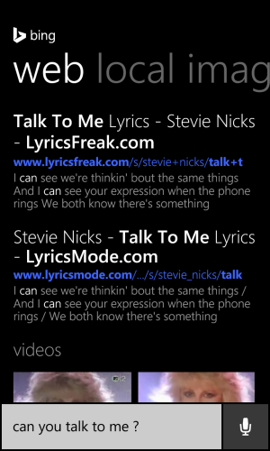

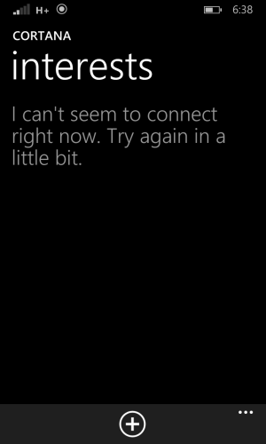

I have Cortana installed but when I open it and say something she will find me answers using bing...she doesn't speak also if i go to setting to set my interests and so on i get this message : " I can't seem to connect right now. Try again in a little bit."....
Help me out

I turned wifi off, did a restart and same problem no matter if i speak to her or if i type it wont speak it gives me answers using bing and also if i go in settings to pick my interest or so it gives me that error...
