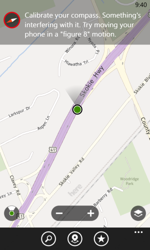

Has anyone experienced any issues with the calibrate compass message always popping up when you use HERE Maps. No matter how many times I calibrate it always pops up. I've attached a screenshot of the message and was wondering if this is just a known issue with Nokia devices or if I have a defective compass. Also, after I calibrate the compass it's also usually still off and not showing an accurate position in which I'm facing. This happens everytime I use it in the car where I mostly use HERE Maps.
BTW, I have restored my phone once already and still getting the same issue. I'm also starting to think that it doesn't work while driving since it works fine while I'm walking outside. Maybe something in my car is in fact interfering with the device compass hence the message.

Wow thanks, that worked! I should've looked that up ages ago but never seemed to remember to do it. :) I would never have guessed that's what they meant by figure 8. Or maybe it isn't, but whatever.. it works.
Ah, I didn't know you waived your wrist in a figure 8 motion. I will try calibrating like this the next time it happens. Hopefully it won't keep asking me to calibrate if I do it in that motion. I didn't think to look up a youtube video of it also since it seemed pretty straight forward on how to move your phone in a figure 8 motion. I was just keeping the phone faced up the whole time. Hope this helps.
thx for the video too. my compass did bring this message all the time, until I realised, that the magnetic lock on my cover is disturbing my compass. so without the cover, and the simple movement in the video, compass calibrates in seconds as intended. Just wanted to share, in case someone has a cover with a magnetic lock on it :winktongue:
Dude you just made me realise its the magnetic cover thats the issue not the phone. LOL LOL
Cheers everyone who advised about the magnetic case. Took the phone out and it calibrated immediately. I wish I'd sorted it before I got lost in Leeds centre last Friday
