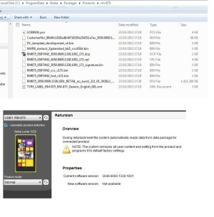

I think that's where I've got too as well - software downloaded but not able to load it through Care Suite, see pics here:
Any advice for next step please?

yep, I got that too. The "downloads" list appears to be empty. it as if its not aware of any downloads done by v4 suite
