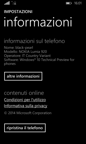

925 updated and working fine so far. I used the Chinese method, subscribed to 'Fast' and rebooted. After that there was no sign of the update in the Insider app, but instead it was downloaded via the standard phone update mechanism.
After all was installed and migrated, the Start screen looked exactly like the 8.1 version. It was only after I changed the background image that the Start screen changed to the new one.
