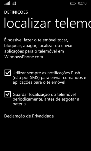

I bet you have security to find your phone ON. So it save your location tine to time.
If you don't like it just disable it.
Go to "todas a defini??es" > "localizar telemovel" > disable second check
