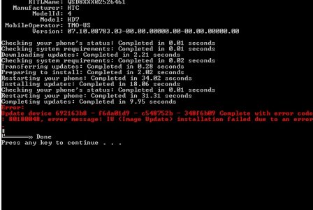

i did download all the files and got to the point of updating my htc hd7 windows 7.5 with details as follows: carrier at&t, OS: 7.10.7720.68, Firmwire Revision: 2250.21.40505.502, Hardware Revision: 0002, Radio: A.24.0.D4, Bootloader version: 4.5.2250.0(129185), Chip SOC: 2.2.50. during the update process the fone restart normally about two times and i got an error: Update device 377ab486 - ef1648a3 - 35242e8b complete with error code: 80180048, error message: IU (Image Update) installation failed due to an error.
please where did i go wrong, kindly help me to update the fone. Thanks in advance
I went to the steps and i have this error :
Error:
Update device e76139ee - 47da5950 - 5c159260 - 3df0a052 Complete with error code: 80180048, error message: IU (Image Update) installation failed due to an error
what to do??

i have successfully updated my HTC HD7 T-Mobile but only 8858-8860 folder 8860-8862 folder got errors tried many times and here is the error :
so does anyone else have this error ?
