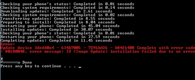

Hello there, My my name is Alex and i have a HD7 by TMO. I am having difficulty with updating my phone to 7.8. At the moment i am stuck on the second folder. I am recinving an error when i try to send the CAB files to my phone.help.jpg
Edit: Read the full website and found out i had to try to install some other files before the ones you gave us but now its done and im 7.8 bound.

Check your OS version and start with the right folder/update files. My phone is HD7, but I had same problem you have described. If your OS version is 7.10.8783.12, then you will have to skip the steps and start with the folder 8783-8858 instead. Hope this will help solve your problem.
