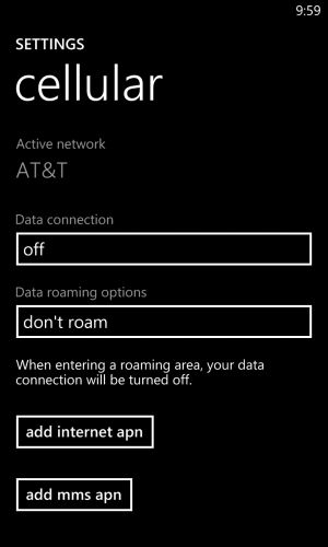

There is a toggle.
Settings > Mobile network
and set the highest connection speed to 3G instead of 4G.
I definitely do not have that on my phone. I can only go to Settings> Cellular and then I get this:
