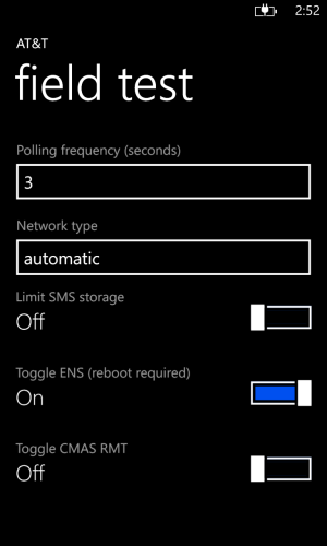

This is what I see when I do that:View attachment 27959so, should any of these settings be changed?
Well it depends how is your data coverage, do you have LTE signal? Like tissotti mentioned a few posts earlier, when your data coverage is bad, phone is looking for network and better signal and that keeps draining the battery. Switching to 3G or edge in some areas might help you prolong battery life.

So does anyone know what the ENS and CMAS RMT settings do? Just curious. The various instructions say to choose the Toggle ENS option, but not a single article says whether it should be on/off or what it does. None of them mention the CMAS RMT setting.
Also, I know that the polling frequency is the rate at which the phone polls the towers for updates (incoming/outgoing calls, text messages, etc.), so adjusting it to one should improve the delays in making/receiving calls and such, but I'm not sure what the cost of battery life would be. In my old Sprint days, it was a negligible impact... as long as you're in decent signal areas.
I read somewhere that ENS has to be turn off (reboot before it can take effect). After that, you can set to 4G or 3G.
CMAS is the Commercial Mobile Alert System, not used in the UK or Europe AFAIK but is enabled in the US. CMAS RMT set to "on" would allow the handset to display what's known as the Required Monthly Test message. Can't see it having any bearing on battery life, IIRC it's just a cell broadcast channel function.
