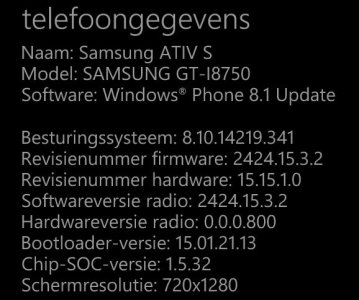

Hi, I changed the CSC to ATO today on my brother's Ativ S and he finally got Windows Phone 8.1. But I've noticed he can't add cellular data to his actions bar. So I thought maybe he needs Preview for Developers, but then I found reports about a potential reboot loop error. Does this problem still occur or can we safely install the latest Preview for Developers?
The current firmware version is 2424.15.3.2
Windows version is: 8.10.14157.200
Also, I can't seem to find which Windows version is which - I mean, do I have 8.1 Update 1 or do I not? If not, why? Phone update says there are no updates.
Yes, you can safely instan .219 update on .15 firware. I have in now and it works even better than stock.
If you don't get it via PfD, get it fromfast ring I sider, that's how I got it.
And yes.157 update is 8.1.1
So I couldn't resist and after several positive reactions on this forum I decided to install Windows Insider on the slow ring in order to get the 219 software with the data toggle. Absolutely did not want Windows 10, so after the 'prepare for install' phase and before updating I uninstalled Windows Insider again. Installation went smooth, at the end there was a text that threatened to prepare for Windows 10 if I would connect it to AC power. So I did not do that, also unchecked PfD and now Phone Update says I have the latest version. I guess I will keep this until Windows 10 comes officially.
