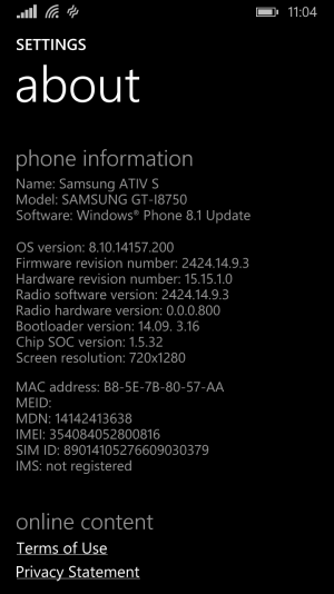

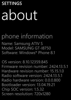

Hi all,
I have an Ativ S, ATO CSC, with the software version that you will see in the screenshot.
It is running Developer Preview. If I try to search for updates, an error message will be displayed with a code (sorry, I did not write it down). I can add it later if needed.
If I uncheck the option to be in the Developers Preview inside the corresponding app, and I go to Phone Update, it will tell me that the phone is up to date. :unhappy:
I have many camera bugs (flash fires randomly, and I cannot film). :angry:
What should I do??? :cry:

What other CSC's you have? Do you have any of the CSC that got the WP8.1.1 officially? (they are mention in the first post of this thread) :)

If I'm not wrong, you have the GDR3 firmware with 8.1 software. So far, acording to my and experience from people on this thread it won't update to 8.1.1 official.
SImple solution is to do as shown in post 1, flash it with GDR2 and allow it to update to official 8.1.1 and bring you the joy of you reborn phone.
Or try changing (if possible) to some of CSCs as shown in first post and see if it will update, but most likely it won't.

Thanks a lot for your answer! I think it has GDR3 firmware.
Bummer, I will have to try the more complex solution. :unhappysweat:

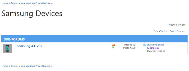

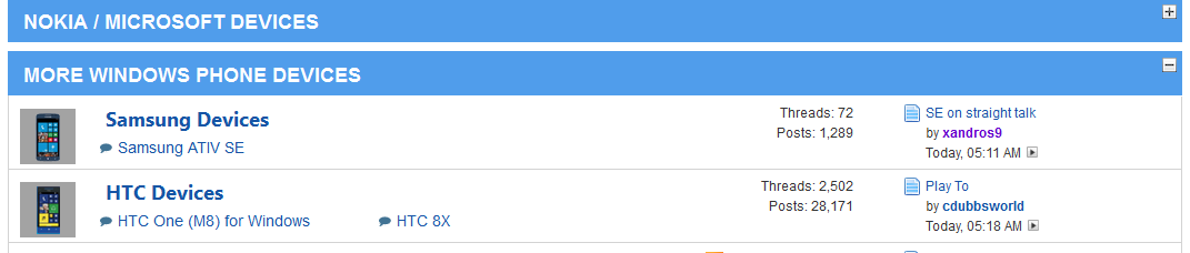

What happened to the Ativ S section in the forum? See http://forums.windowscentral.com/
Since a couple of days it is gone. It only shows Ativ SE
Also not there in section Samsung Devices
Edit: I found it. It is now under "Windows Central Archives"
I guess we are ancient now.
