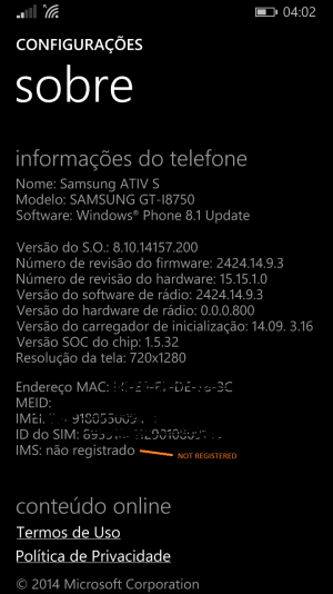

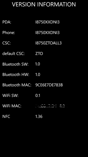

My phone had only CSC ZTO (Brasil) and now it has win 8.1.1 (CSC ATO). I did everything explained on page 1. Now I have 6 CSCs: ATO, BTU, DBT, ITV, XEF, and XEO. Everything is Ok. Just one problem : I receive alerts from my mobile operator every minute. I don't know what is that. I think the return to CSC ZTO would remove this problem, but there isn't this choice. Some suggestions ? Apply interop-unlock ? Thank's.........
You could try flashing just the ZTO csc
How could I do this flash ? What file can I use ? I'm not so expert doing this. I follow exactly the explanation on page 1, using WP8 SMD binary USB Downloader Ver. 3.47.exe. To modify only the CSC using a file (and, what file ?), I don't know how. Thanks again.....

I did everything explained on page 1, again. In ATO i donwloaded and installed every versions. When the phone begin downloading Win 8.1.1, only downloading (not installing), you turn off it and install only CSC ZTO (GT-I8750_VJALL3_P.csc). After this, you turn on the phone, go to update software and it will continue downloading Win 8.1.1 and installing it. Now, everything works well. When installing, it uses the new csc ZTO. I followed the instructions posted in youtube by someone...........Thanks to all........
So, bottom line: Your ATIV S is running now on Official WP8.1.1 (including official Samsung firmware), is that correct?
