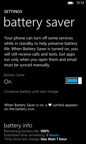

I have already read and done guides in how to prolong your battery life and
I already turned off the location,wifi, bluetooth, background tasks and such, but i still get this battery.
PROBLEM SOLVED:smile:
Thanks to Nokia Care who took my phone for almost 3 months to fix it.:cry:
I left my device in standby mode with 35% battery, after 8 hours I only have 8%.
Can't even last a day. :cry:
Is this normal?
(I bought my Lumia 720 3 days ago.)

I wouldn't worry about it. For example, sometimes it shows me that estimate time remaining is for example 1 day, then after few minutes it shows me 4 days, all depends on what apps/processes are currently being used. If you turn off everything and look at battery saver settings after few minutes the remaining time will change :)

The estimated time reaming is not accurate. Once you start to use your phone, it will go down.
