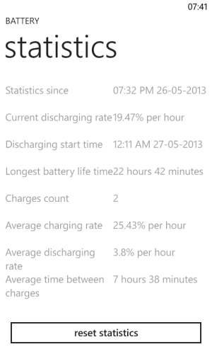

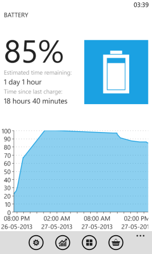

This is my normal usage when internet is off. These statistics are for over the night.

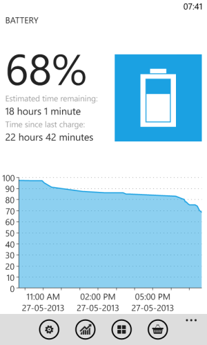

And when I turned on the internet in the noon this is what happened!
I have my nfc off bluetooth off and I also did soft reset plenty of times. I have even tried to full discharge it and then charging it. BTW I have whatsapp, FB, Twitter, Battery, skype installed in my handset. I don't use twitter and skype and my discharging rate gone up to almost 20 % per hour.

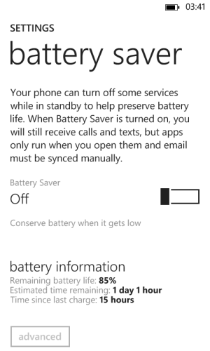

Recently my 720 battery drains a lot than before... after 100% charging estimated time remaining is only 23 hrs ?? is there something wrong with the battery or should i just do a hard reset (already did a soft reset a couple of times) !!
But does it actually run out of charge after 23 hrs? The estimated time is just that...estimated! Try running the phone until it shuts down and see how long it really does last.
If it is draining faster than it used to, perhaps it's an app you've recently installed. Have you checked what's allowed to run in the background?
I have whatsApp installed, Hike(like whatsApp) and Youtube allowed in background task .. oh and battery+
There have been many reports of WhatsApp causing battery drain issues. Search the forums for more info. Perhaps uninstall WhatsApp and see if your battery life returns to normal.
