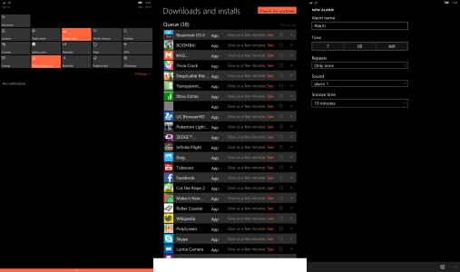

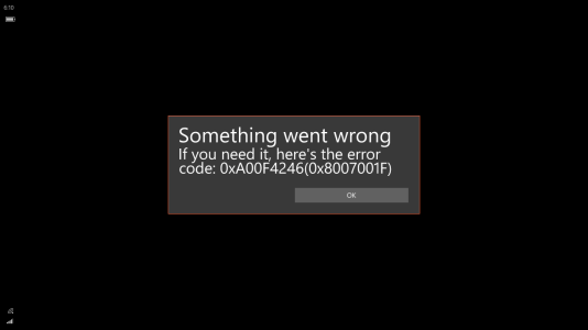

My HTC 8x finally got 10536 update (and its terrible)
