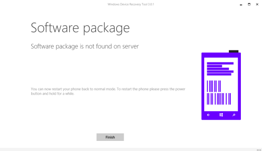

After downgrading to 8.1 I tried once again the whole process and it finds the same software to flash so I believe its device model related more than anything. See the screenshot, I have a HTC C625b ...
North American versions seem to be HTC C625a with diff firmware/hardware versions. ie.. my hardware is 0000 and firmware ends at .631
Good to know Peter, also worth mentioning is that once the 8x is connected and recon by WPRT it listed my device firmware as unknown as you can see in the capture above.

Huh... still no software package found on the server... wonder how much time it will take for them to fix this.. its been week since i operated a smartphone lol
Found software on the server finally using Microsoft recovery tool... downloading 764.41 Mb now!
