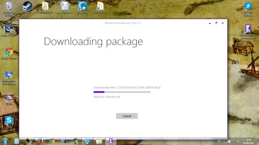

As of now Im flashing my HTC 8X using the Windows Phone Recovery Tool.
Just could not have W10 buggy on my main device. It seemed strange out of the blues to receive a notification that it was already available, should have checked prior to installing it.

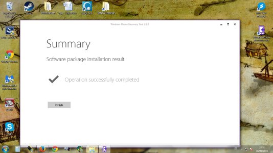

Rebooting now and it seems W10 is gone after flashing :)

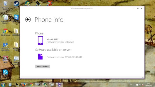

Just tried once again connecting my HTC 8X on bootloader (flash mode) and after windows recognizes it as a USB BLDR it finished installing the drivers and it shows as HTC Active Sync , then just proceed to open WPRT and even if it says Not found when clicking on HTC it automatically detects the device and searches the repository for available firmware, in my case with the following result:
1-Make sure you connect your device while the barcode white screen (flash mode) is selected otherwise it won?t work.
(Press power and once it vibrates immediately press AND hold VOL+ and VOL - keys simultaneously till you see the white barcode screen)
2-Plug device to PC
(Wait for Windows Update to install necessary drivers).
3-Run Windows Phone Recovery Tool
Hope that helps.
