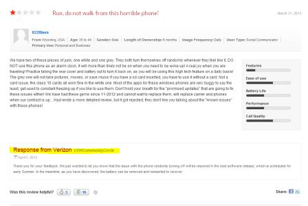

I have had two 822 devices since November, and they both had this issue where the screen would stay black when I tried to unlock the phone or they would randomly reboot. I have tried a device exchange (that's why I had two), system reset, and SIM card exchange. It froze up this morning after my SIM card exchange yesterday. The only other option I can think of to try is sending it to Nokia. I went to a Microsoft store recently and they said they would exchange it for an 8X if I can't get it fixed.

My 822 was having the lock up issue also. I finally sent it to Nokia last week. I just got it back today and it just shut itself off. Obviously Nokia did not fix the problem. I will be contacting them on Monday demanding a replacement.
Hi, just wanted to let you know that this issue has been identified and will be resolved in the next SW update scheduled for early summer. In the meantime, you can pull the battery or hold the volume down button and the power button at the same time for 5-10 seconds to reboot the phone. We are very sorry about the inconvenience this causes.
