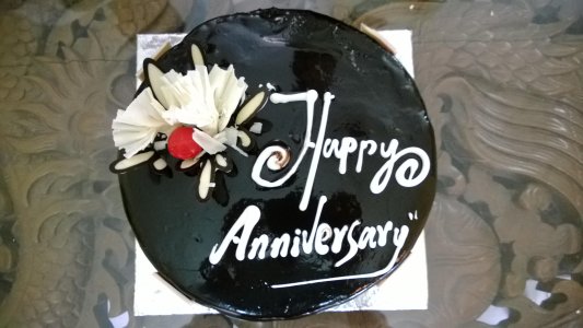

WP_20130817_00_01_54_Smart.jpg via smart cam

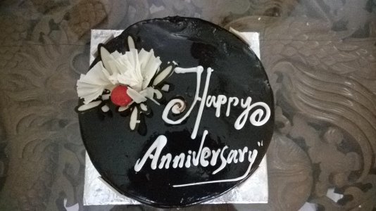

WP_20130817_001.jpg via the native camera app
l920 updated to amber via OTA today, installed nokia pro cam and nokia smart cam via the store link
noticed that the smart cam takes blurrier pics than the native camera app ( hav attached the pics )
tried del n reinstalling the smart cam but ended up with the same results
anyone else notice this ???
pro cam is a bit better than the smart cam app but m guessing thats due to my photographic skill n knowledge, but smart cam shuld atleast take better pics than the native app !

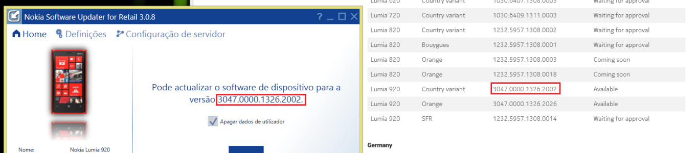

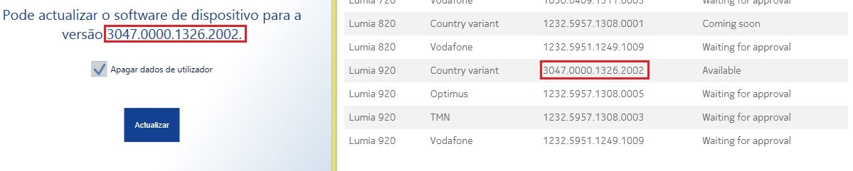

Hi, I still don't have the update installed It didn't show up yet in OTA but I don't know why
My mobile operator is (000-FR) unbranded phone (I guess)
And I'm currently living in Portugal but In bouth countries the Country Variant Update is available. But I can't get update.
Sem T?tulo.png -> France
Sem T?tulo1.png -> Portugal
Any ideas why this is happening? I don't want to use nokia software updater for retail because I don't want to loose all my data.
View attachment 40382 -> France
View attachment 40383 -> Portugal
Try taking your phone to the nearest service centre. They can update your phone.

View attachment 40364 via smart cam
View attachment 40365 via the native camera app
You are so much confused. Smart cam app captures 10 shots at a time which are 5 mp in resolution. Pro cam app enables stereo recording,iOS up to 3200,manual focus,lose less zoom in videos,etc.
