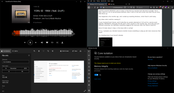

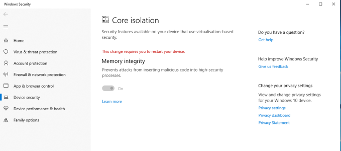

As I was checking, I just noticed core isolation was disabled... it's one of the first things I enable after every install.... so I have had to enable it again. Not happy.
