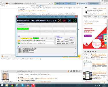

You need:
-WP8 SMD binary USB Downloader Ver. 3.47.exe
-GT-I8750OXXCMK2_R_SIGNED.csc(firmware/gdr3)
-I8750XXCMK2_I8750XCMK2(firmware/gdr3)
-SamsungUSBDriver.msi(install this on pc first)
Than run WP8 SMD binary USB Downloader Ver. 3.47.exe as administrator and select like in this picture.
I selected NEE because I heard that they getting faster updates then others.
