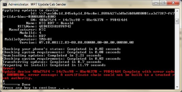

Hi,
I need some help!
I have an htc hd7 and I followed all the instruction so far. I was able to update to 8107-8112. I then proceeded to 8112-8773 and then got the following error:
Error:
Update device 48bd75f4 - 14c7cc90 - 0bc46378 - 998414d4 Complete with error code: 800B010A, error message: A certificate chain could not be built to a trusted root authority.
Thanks,
Ronald
