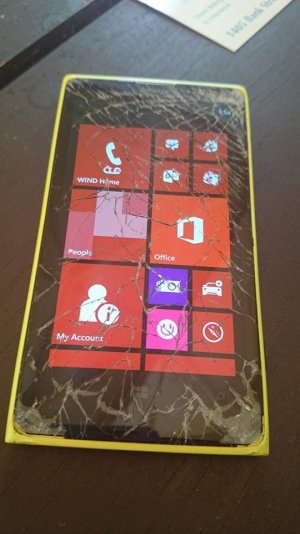

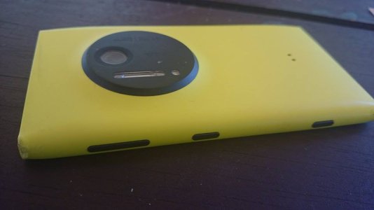

Hi all,
Long story short, i forgot my phone on top of my car-, someone found it on the road(gave it to his son to look at it), and i was able to get it back.
It had the camera grip attached with a mini tripod. I am completely crushed as it has been hard reseted. All my files are gone, but im still glad i got it back as it still somehow works. Camera lens part might have been saved by the camera grip during the incident as it works perfecly fine.
Problems:
The front cam and the sensor seems to be broken as glance doesnt work.
Whenever i make/receive a phone call the screen just blacks out, but the call still go though(sensor problem i guess), but i can not hang up or anything.
Now, i am thinking, is it worth getting repaired?? does anyone know how much it cost to replace the screen and body?

i could be wrong but what if no sensors or camera is broken and u just need the screen repaired.
the glass is shattered where i assume the proximity sensor and front cam is.
but i dont know how exactly the prox sensor works.
it might work and it might not
Hi guys thanks for the advice.
now my next question is, is there a way to turn off the sensor beside
the front cam? It seems to be my only problem as whenever I make a call, it thinks its beside my ear, so the screen just turns black and disables all the buttons except the volume rokr
I don't think there is.. but a possible workaround is using a handsfree kit for the time being so you can still do calls.

If it was mine id be replace the screen /digitizer assembly as one ,even though your display is still working and its the outer digitizer that is broken as the two are bonded together as one
I don't think the new screen/digitizer come with the camera & sensors ,and that would be a separate part that just pushes in and secured by double tape.

I think it;s VERY likely that the sensor is fine and its just the cracked glass makes it mess up. I had an issue with my 920 doing exactly what yours did due to some dust. I was able to fix it by cleaning the dust out.
Since the phone is messed up, I'd recommend attempting to peel some of the glass away from the top right corner where the sensor and camera are. You might find that fixes it. Then you would at least know that having the digitizer/screen replaced(if they're 1 piece) would sort everything out.
If it was me I'd peel the glass off that corner, then depending on the length of my contract/price of the replacement I'd decide whether to repair it or replace it or leave it.
