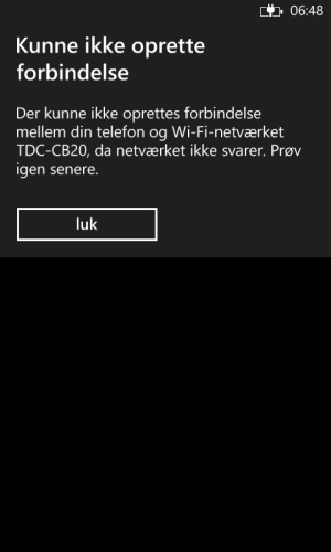

Hey, so I just got my new Lumia 520, but it doesn't seem like it wants to connect to my WPA2-protected home Wi-Fi. I've tried turning off the WPA2 protection, but still I just get a time out / no response when trying to connect on my L520 :(. I use this Wi-Fi on my Surface and other phone(s), but it doesn't seem work with the L520. I've tethered with my other phone to update the L520, and it connected fine to the wireless hotspot over Wi-Fi. Does anyone have any ideas what may cause this / how to fix it? My internet is provided by TDC.

Had the same issue earlier today. (brand new 520) If I typed in a bad password it would tell me immediately, otherwise is would just come back and tell me it had timed out. My issue was resolved by restarting my router and then restarting the phone....

I had the same issue but I have changed it with warranty. If you restart your phone then it might solve it but it is not the permanent solution.

I had the same problem. The solution is go to configuration and do the reset. It will repair your wifi and 3g.

anyways, I'd make sure the routers plugged in to internet and try turning it off and on. (both the phone and router)
actually, soft reset your phone by holding down the volume down and power buttons until it vibrates.

HELLO EVERY ONE.....ITS SIMPLE......YOU MUST LOG INTO WIFI ROUTER...AND....UNDER WIFI.....SETTINGS........ADD YOUR LUMIA MAC....ADRESS.......ON WIFI ACCESS LIST!(THE MAC ADRESS YOUR WILL FIND UNDER PHONE SETTINGS.....ABOUT.....MORE INFO....MAC..XX:XX:XX:XX:XX:XX)......YOU NEED TO REPLACE UNDER SCORE WITH COLON....WHEN YOU ADD YOUR MAC ADRESS...IN YOUR ADSL(ROUTER)...AND WALA.......YOU DONE!
