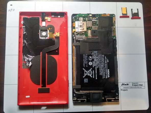

Hello Team. I have a question. This picture, what's control? What does it do?Untitled-1.jpg
Hello Team. I have a question. This picture, what's control? What does it do?View attachment 101437
I think it makes contact with back cover to enable some type of functionality like connecting the top headphone jack to the motherboard. Here's what I could dig up.
https://www.ifixit.com/Document/1136/.pdf
See this picture. See how it lines up. From IFixit
V6UixQR5rX3hDFFq.medium
