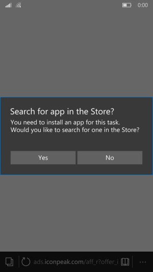

Most of the times when i click on a link, Edge loads that page and after a second redirects me to sites like ads.iconpeak . com, asking me to install non existing apps, or letting me know that my "adroid phone" is affected by viruses etc. After i go back and reload the initial page, everything is ok.
Same thing happends if i type an adress myself. On WI FI or when using mobile internet connection.
Windows 10 should be safe from viruses etc, hence there are no antiviruses for the platform.
What i noticed is that after it redirects me, i can browse on any page without further issues. After a few hours when i use Edge again, it redirects me to an ad site.
I was wondering if anyone has this problem also.
This is what i got after i typed windowscentral.com.

Thx info. Never heard of this before. Never experienced it either. Does it happen when the page renders in mobile and desktop mode? Does it happens if you hard reset the phone? Try hard reseting the phone and do not opt to restore from backup and try it.
It could possibly be an full page ad overlaying above the page that's completely transparent and whatever you click on the page will trigger the overlay ad and bring up another page, making you think it's redirecting you. Just a thought. Hoping it's not malware...last thing we need.

Problem seems to be solved now. I did reset without restoring, on newer build also. Not sure when it happened, but the problem went away. Hope it will stay like that.

Went away because the cache deletes oldest entries or the smart screen filter updates its list and blocks it.
The next time press the back arrow more than one time till you land on a normal previous page, or press Tab and close it, and enter in settings and delete cache and history. It's not a virus or malware, simply an annoyng redirect pop-up . same as desktops
