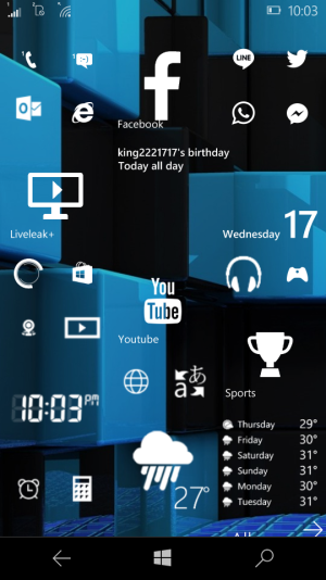

  • Blurry app icons on the Start screen
  • Lag after tapping on Start screen items

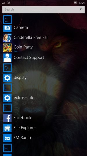

Could you check and see if you have an EXTRAS in your setting menu? I have a 1520 on ATT and I don't have Extras as an option.
Check if Extras is listed in the app listings. I found it, along with glance and motion, briefly. They showed up after a hard reset. Pin them to the start screen if you see them because they will disappear.
It's in the app list menu, but tapping it doesn nothing because it's not technically installed and the Store gives an 0x80240024 error when trying to install it.
– cant set english as default language. L830 doesn't restart bringing selected language.
– microsoft marketplace dosen't show my device. so i cant use 'find my device' or use the marketplace to download apps
– blue skies app tile doesnt work
I'm not looking for the Extras+Info that displays the the Lumia info, but the All Settings \ Extras that has Hey Cortana, Touch and number of other settings under it.
