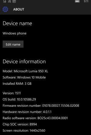

I have been tearing my hair out on the inability to upgrade to 10586.36. I always get the 0x80188306 error. Ive tried soft resets, hard resets. I was able to get to 10586.29 and upgrade the firmware from latest update which is something. Ive seen lots of users saying the same but no dedicated threads with advice. Has anyone been able to solve this? A fresh install with no Insider shows .29 being latest update. Then install Insider and fail at 1% with 0x80188306 error every time. Tried different wifis, different process in steps etc. Absolutely stuck.

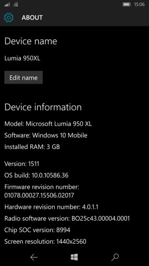

That is not correct. I got .36 several days before I received the firmware update.
The Single sim XL can't get the .36 update. It's the same for me and countless others. Only the Dual sim 950 xl got the update.
Well, I have a single SIM 950XL and I got the .36 update.

I can't even get past the 0.29 update. Still the same error. Nothing I can think of or scrounge up from the internet works. It really shouldn't be this complicated. I'd rest easier knowing the cause of the issue but can find nothing. Very disappointing indeed.
Sorry I should have been more clear about my post. I am on the same boat. I am currently on .29. Cant update to .36 OR .63 both have the same error. I was really hoping .63 released today fixes the issue!

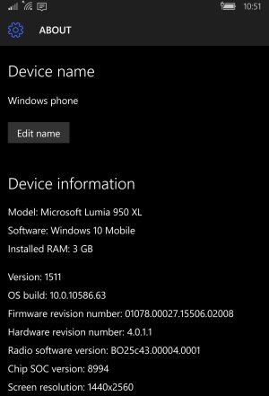

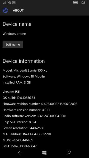

I am happy to report the same with me. I flashed the 10586.11 factory image via WDRT. After installing Windows Inside and checking for updates, the 10586.63 update was available for download.
What is interesting is that I was expecting the 0.29 update to be downloaded and installed via th Fast Ring, like before. Previously, the 0.36 update would show after I had installed 0.29. Now, I have gone from .11 to .63 directly without a hitch. Here is a shot from the about screen:
