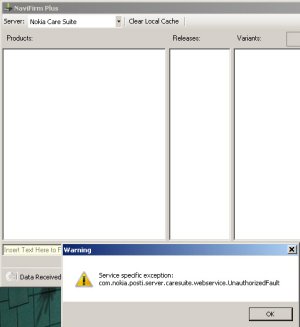

This fix seems broken at step 2. The server errors out, and there is nothing at all in the products box for me. Any idea how to proceed?
