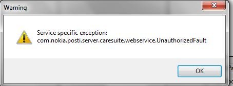

getting a error in navifirm plus.
service specific exception:com.nokia.posti.server.caresuite.webservice.unauthorizedfault
Help!
