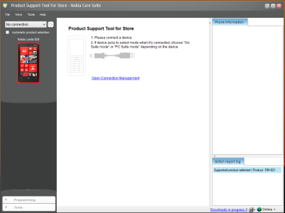

Cant get Nokia Care Suite to install, just says the wizard was interuptted and could not install.
You more than likely need to install the VC++ software seperately like I had to do. Right before that screen it asked if you wanted to download and install a particular package from microsoft. Below are the links to the Microsoft download spots for both the prereqs:
Download Microsoft Visual C++ 2010 Redistributable Package (x86) from Official Microsoft Download Center
Download Visual C++ 2005 SP1 Redistributable Package (x86) from Official Microsoft Download Center

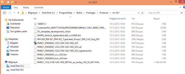

my recovery keeps failing . comes up with error message : The file 'C:\ProgramData\Nokia\Packages\Products\RM-821\RM821_1232.2109.1242.1001_RETAIL_apac_hong_kong_305_01_99635_prd_signed.ffu' from the data package is corrupted.
I tried other roms , getting same error .

i do every step properly but RM-820 (Nokia Lumia 920) does not appear on
under Nokia_Care_Suite_5.0_2012.45.4.5 Directions need fast help....
